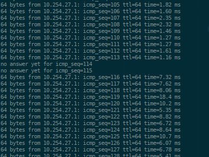

I did a test tonight. Made sure BFD session was up, across the RF link, setup a ping at 0.5 second interval to the remote router, so 2 per second, and hit the firmware update button on the RF link. This is BFD running on eBGP, and I was pinging the local address on the remote router which is reachable over multiple links. We only lost 2 packets, so 1 full second, before BFD triggered a route drop and BGP rewrote the routing table. I’m super happy with that.
