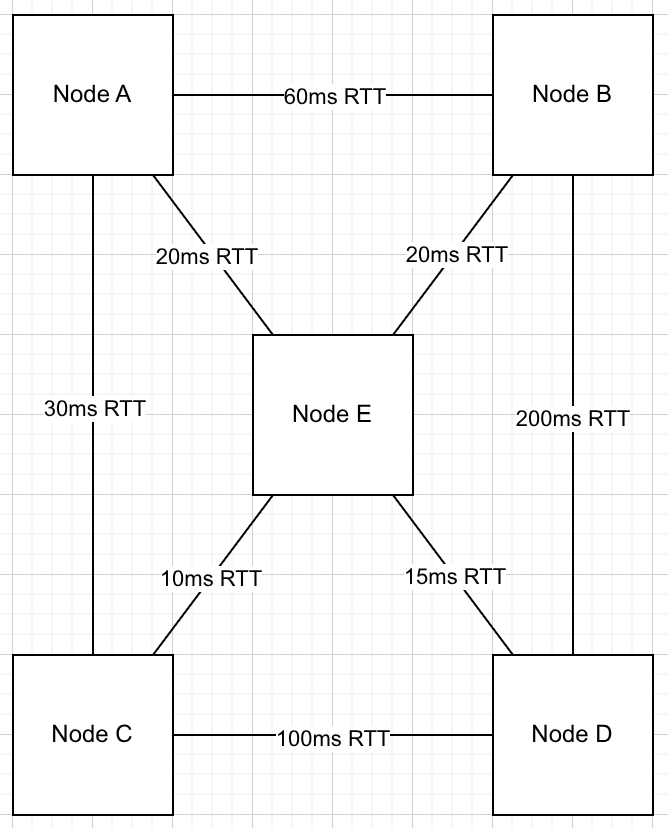

Example fictitious logical eBGP topology:
From a logical standpoint, the “shortest” path between Node B and Node D is the direct path, but the “fastest” path is actually B <> E <> D.
When Node E receives Node B’s prefixes, it imports them with a metric of 20. When Node E re-advertises Node B’s prefixes to Node D, it passes along a metric of 20, and when Node D imports them it adds 15 to the metric for an installed metric of 35.

I figured this was the case as it goes against BGP spec, so it makes sense. The good news is I have no real world application for this…it’s just something I’ve been contemplating if there is a feasible way to relay path latency.
I suppose if each peer adds RTT to routes at import, you can tweak BGP best path selection to prefer the peer with the lowest metric, but that doesn’t necessarily guarantee that the lowest latent peer is the lowest latent path.
I think if I were to cobble a script together, it would need to do the following:
  • For routes a peer originates, it likely is fine to send metric of 0 because we can rely on the receiving peer to set metric to RTT.
  • For routes a peer re-advertises, it would need to grab the lowest metric for a given route and re-advertise it. The receiving peer would then add RTT of the sending peer upon import.
I think it could work, but I don’t think it would scale well. Definitely something to ponder, heh!
