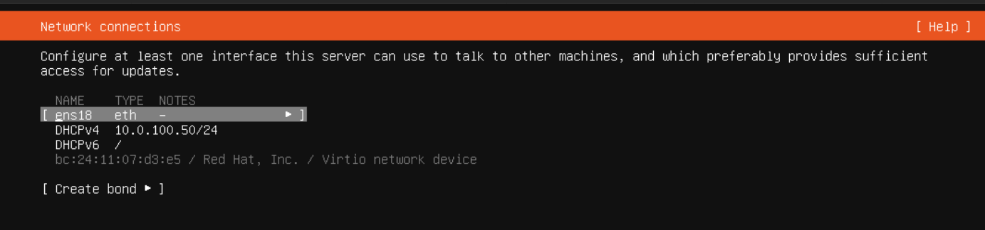

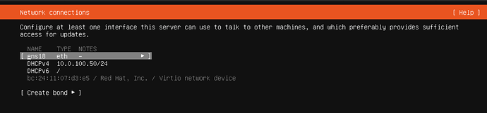

In the Ubuntu server installer, I put the VM on this VLAN, and I chose DHCPv6 during the install process and it just spins. This little line is a spinning one on the the real screen. So clearly something is not right.
