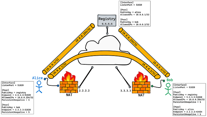

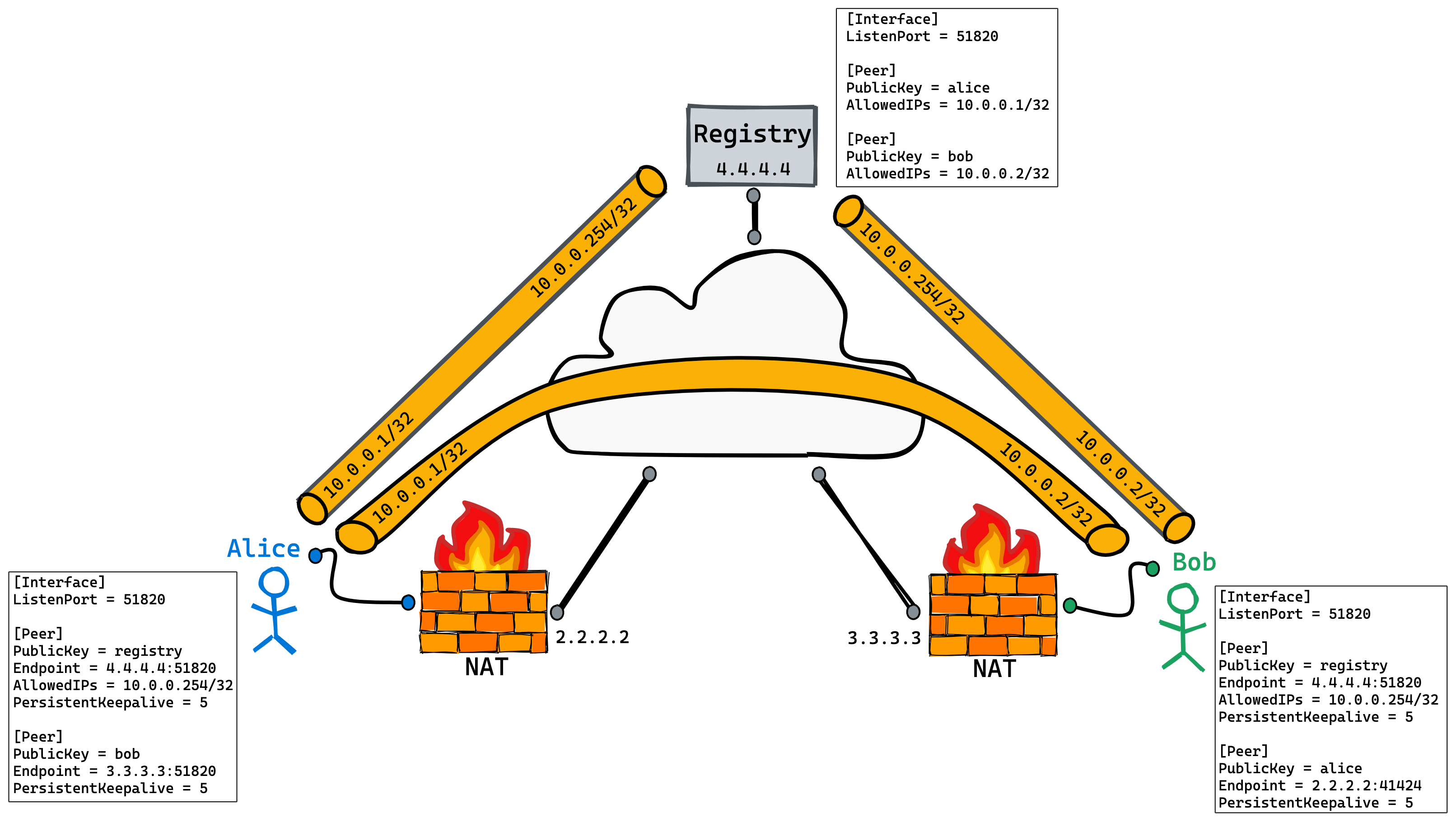

Can we let vyos support wgsd ,then we can let vyos support WireGuard Endpoint Discovery and NAT Traversal using DNS-SD. It can let 2 wireguard nodes behind nat to connected directly.

In the current implementation 2 hosts can’t communicate if they both behind NAT
Even if at least one have portforwarding enabled through their firewall?
Connecting in a star network as the drawing above is basic routing once wireguard tunnels are established to the central point.
With DNAT, of course it will work.
The main idea it not to use HUB for traffic forwarding, so peers will communicate together without HUB.
And traffic flow will be directly between peers.
