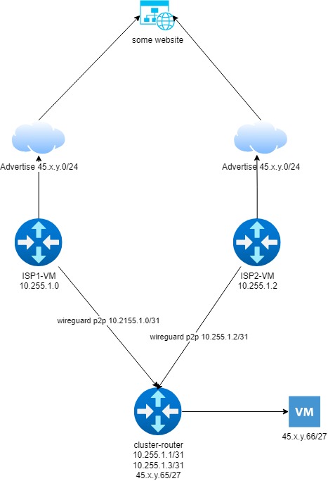

Hello,
I hope I’m asking in the right place. I’m out of ideas…
I do have two VPS with different ISPs. Both will provide me full BGP-Table and advertise my /24 with my own ASN.
For convenience, I’m limiting this to ipv4 only.
Both systems are connected via wireguard p2p to a vyos-vm in my router. It will get the full table from both ISPs via iBGP (also tried OSPF, but that’s the same issue).
All routers are running the rolling release 1.5
Behind the cluster-router there are a few IPs.
the connections will look like this.
(please don’t mind not competly matching IPs, since I did that with other providers)
If I only have one router active, everything works like I would expect it: Traffic from my VM is routed through the cluster-router over the ISP-Router and then into the global internet.
If I’m now enabling the 2nd VM, I do get asymmetric routing for a few locations - which, as I learned, is perfectly normal.
Unfortunately the whole system breaks, and there is no connection being established between the internet and the VM, when there is an asymmetric routing.

set service ntp server time2.vyos.net
set service ntp server time3.vyos.net
set service ssh port '422'
and the config of the cluster:
set interfaces ethernet eth0 address 'dhcp'
set interfaces ethernet eth0 description 'WAN'
set interfaces ethernet eth0 hw-id 'bc:24:11:7a:23:1b'
set interfaces ethernet eth0 ip source-validation 'loose'
set interfaces ethernet eth0 ipv6 source-validation 'loose'
set interfaces ethernet eth0 offload gro
set interfaces ethernet eth0 offload gso
set interfaces ethernet eth0 offload sg
set interfaces ethernet eth0 offload tso
set interfaces ethernet eth1 address '45.x.y.65/27'
set interfaces ethernet eth1 address 'a.b.c.65/27'
set interfaces ethernet eth1 description 'LAN'
set interfaces ethernet eth1 hw-id 'bc:24:11:cd:59:b1'
set interfaces ethernet eth1 ip source-validation 'loose'
set interfaces ethernet eth1 ipv6 source-validation 'loose'
set interfaces ethernet eth1 offload gro
set interfaces ethernet eth1 offload gso
set interfaces ethernet eth1 offload sg
set interfaces ethernet eth1 offload tso
set interfaces ethernet eth2 address '<public ip>/32'
set interfaces ethernet eth2 hw-id '00:50:56:0c:d0:1e'
set interfaces ethernet eth2 ip source-validation 'loose'
set interfaces ethernet eth2 ipv6 source-validation 'loose'
set interfaces loopback lo
set interfaces wireguard wg1000 address 'fd80::100:1/127'
set interfaces wireguard wg1000 address '10.255.1.1/31'
set interfaces wireguard wg1000 description 'ifog-to-cluster'
set interfaces wireguard wg1000 ip source-validation 'loose'
set interfaces wireguard wg1000 ipv6 source-validation 'loose'
set interfaces wireguard wg1000 peer to-IFO address '118.91.186.26'
set interfaces wireguard wg1000 peer to-IFO allowed-ips '0.0.0.0/0'
set interfaces wireguard wg1000 peer to-IFO allowed-ips '::/0'
set interfaces wireguard wg1000 peer to-IFO persistent-keepalive '15'
set interfaces wireguard wg1000 peer to-IFO port '61800'
set interfaces wireguard wg1000 peer to-IFO public-key 'xxxxxxxxxxx='
set interfaces wireguard wg1000 port '61800'
set interfaces wireguard wg1000 private-key 'xxxxxxxxxxx='
set interfaces wireguard wg1002 address '10.255.1.7/31'
set interfaces wireguard wg1002 address 'fd80::100:7/127'
set interfaces wireguard wg1002 description 'v6node upstream'
set interfaces wireguard wg1002 ip source-validation 'loose'
set interfaces wireguard wg1002 ipv6 source-validation 'loose'
set interfaces wireguard wg1002 peer to-V6N address '185.23.5.140'
set interfaces wireguard wg1002 peer to-V6N allowed-ips '0.0.0.0/0'
set interfaces wireguard wg1002 peer to-V6N allowed-ips '::/0'
set interfaces wireguard wg1002 peer to-V6N port '61802'
set interfaces wireguard wg1002 peer to-V6N public-key bbbbbbbbbbbbbbb='
set interfaces wireguard wg1002 port '61802'
set interfaces wireguard wg1002 private-key
bbbbbbbbbbbbbbbbbbbb='
set protocols bgp address-family ipv4-unicast network 45.x.y.64/27
set protocols bgp address-family ipv4-unicast network a.b.c.64/27
set protocols bgp neighbor 10.255.1.0 address-family ipv4-unicast remove-private-as
set protocols bgp neighbor 10.255.1.0 address-family ipv4-unicast soft-reconfiguration inbound
set protocols bgp neighbor 10.255.1.0 description 'ifogch ipv4 upstream'
set protocols bgp neighbor 10.255.1.0 remote-as '<my as>'
set protocols bgp neighbor 10.255.1.0 update-source 'wg1002'
set protocols bgp neighbor 10.255.1.6 address-family ipv4-unicast remove-private-as
set protocols bgp neighbor 10.255.1.6 address-family ipv4-unicast soft-reconfiguration inbound
set protocols bgp neighbor 10.255.1.6 description 'v6node ipv4 upstream'
set protocols bgp neighbor 10.255.1.6 remote-as ''<my as>'
set protocols bgp neighbor 10.255.1.6 update-source 'wg1002'
set protocols bgp parameters bestpath as-path multipath-relax
set protocols bgp system-as '<myas>'
set protocols static route 0.0.0.0/0 next-hop 162.19.204.254
set protocols static route 10.0.0.0/8 next-hop 10.10.1.254
set protocols static route 118.91.186.26/32 description 'ifog ipv4'
set protocols static route 118.91.186.26/32 next-hop 162.19.204.254
set protocols static route 162.19.204.254/32 interface eth2
set protocols static route 185.23.5.140/32 description 'v6 ipv4'
set protocols static route 185.23.5.140/32 next-hop 162.19.204.254
set service ntp allow-client address '127.0.0.0/8'
set service ntp allow-client address '169.254.0.0/16'
set service ntp allow-client address '10.0.0.0/8'
set service ntp allow-client address '172.16.0.0/12'
set service ntp allow-client address '192.168.0.0/16'
set service ntp allow-client address '::1/128'
set service ntp allow-client address 'fe80::/10'
set service ntp allow-client address 'fc00::/7'
set service ntp server time1.vyos.net
set system config-management commit-revisions '100'
set system console device ttyS0 speed '115200'
set system host-name 'bgp-cluster'
set system login user vyos authentication encrypted-password 'asdfasdfasdf'
set system login user vyos authentication plaintext-password ''
set system name-server '10.10.0.2'
set system name-server '10.10.0.1'
set system name-server '10.20.0.2'
set system syslog local facility all level 'info'
set system syslog local facility local7 level 'debug'
I also tried to use other providers, but got the same issue on the asymmetric routings.
I do suspect, that i’m missing something trivial but fundamental here … But I don’t know what ecactly.
Should I also redistribute the BGP-routes between the (currently) not connected ISP-Routers?
I’m out of ideas what could be the issue here :frowning:
I appreciate any help and ideas.
thank you for reading this wall of text.
