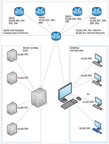

Here is my setup:
The screenshot shows VyOS router that will run VyOS podman containers, each behaving as its own router. This allows me to do things such as configuring OSPF that can bridge between routers within each of the containers. What’s physically attached to the VyOS router is my server and my desktop, each having VLANs that gets assigned to its own bridges (br300, br301, etc.). The same goes for my home server.

With the setup and the snipped config file in mind, is it possible to assign bridges to podman containers so I can perform routing within the containers? Or am I better off putting VyOS in its own VM and setup additional VMs for virtual routing setups? The reason why I’m going for this is because I want to setup some make-believe companies that make use of Windows Server Cores in separate VLANs in my server along with running Windows 10/11 VMs in virtual machines in my desktop.
