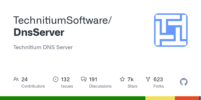

Digging some more Technitium seems to have been around for some time and have a public repo at:
It seems to be a one man show, at least thats the impression I get from their About us page.
However looking at the stats regarding CVE’s its seems to be a better option than what ISC is releasing.
