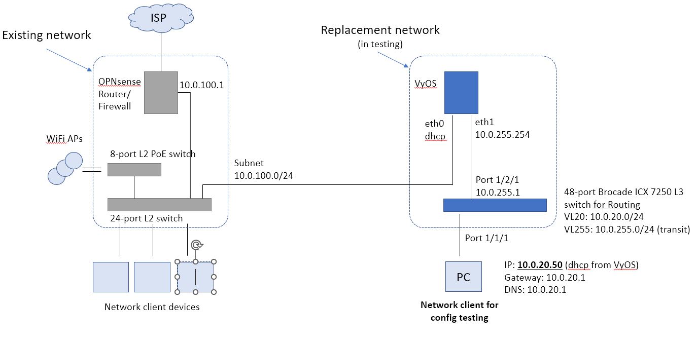

Can't resolve DNS behind L3 switch
Hoping someone smarter than me knows the answer to this → I cannot resolve hostnames from the PC (ip: 10.0.20.50) connected to my network as depicted in the image.
I’ve set up a simple network with VyOS as firewall/dhcp server connecting to an L3 switch configured as a router (inter-vlan). Main points are:
  • The PC is physically connected to the switch.
  • DHCP from VyOS works. The PC receives it’s IP addresses (machine, gateway and dns server)
  • I can ping internet and resolve hostnames from both VyOS (10.0.255.254) and from within the switch (10.0.255.1) when connected through SSH.
  • I can ping internet from the PC if an address is entered but I cannot resolve hostnames … this part is eluding me still.
Some further info below on what works/doesn’t work from the PC
From client PC (ip: 10.0.20.80, gateway: 10.0.20.1, dns 10.0.20.1)
% nslookup examplehostname.com 10.0.255.254 → works
% ping ipddress (e.g. 8.8.8.8) → works
% nslookup examplehostname.comdoesn’t work → I get: “;; connection timed out; no servers could be reached”

In your DHCP config, it looks like you’re setting the name-server to the gateway on the L3 switch instead of 10.0.255.254.
Thank you @L0crian you found the issue and it’s now fixed ! I think I was under the impression that the vlan gateway would resolve back to the LAN (eth1) on its own but clearly this wasn’t the case.
Here is the update to my prior config above showing the change to the name-server for the benefit of the community:

No worries, glad you got it working!
I have one suggestion; host whatever IP you want to use for the DNS forwarder on a dummy interface. This ensures you have an always up interface to use for that. If you add remote-access VPNs or additional LAN interfaces later, they could potentially have DNS fail if eth1 were to go down.
@L0crian thank you for the suggestion to use dummy, never thought of that use case. Interface dum1 created and applied :grinning: )
