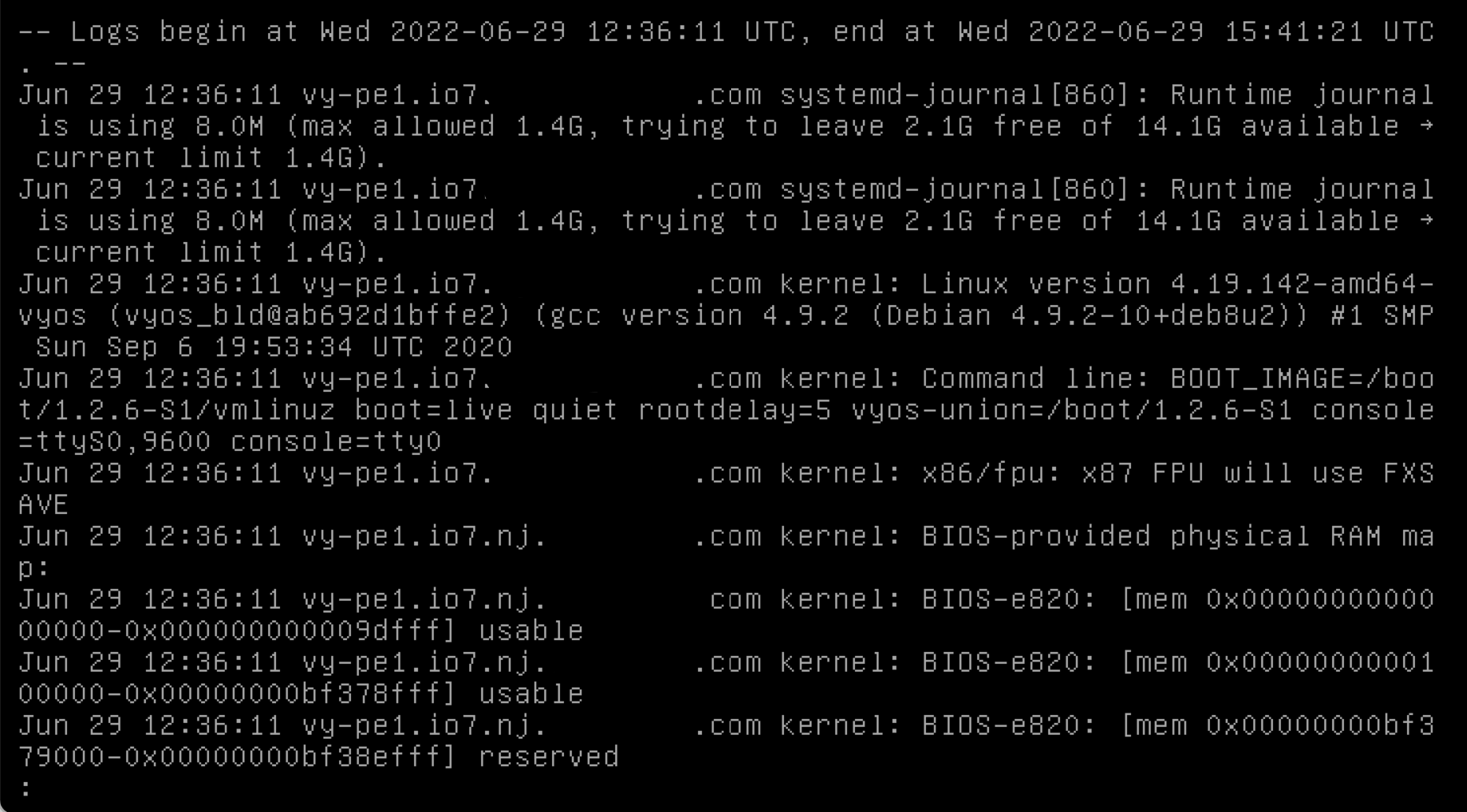

I ran ‘show log’ and this is the output on each router.
