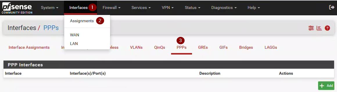

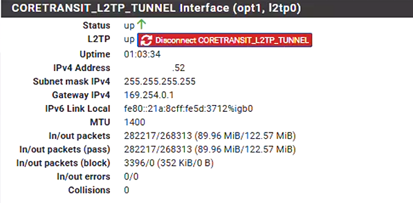

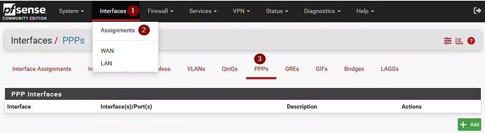

I’ve been playing around with CoreTransit’s Static IP Anywhere service, and I’m currently using it with pfSense to get a public IP through an L2TP tunnel. It works great, basically, pfSense connects via L2TP, authenticates with CoreTransit, and I get a routed public IP on my WAN side over the tunnel.
I wrote up how I got it working here if anyone’s curious:
