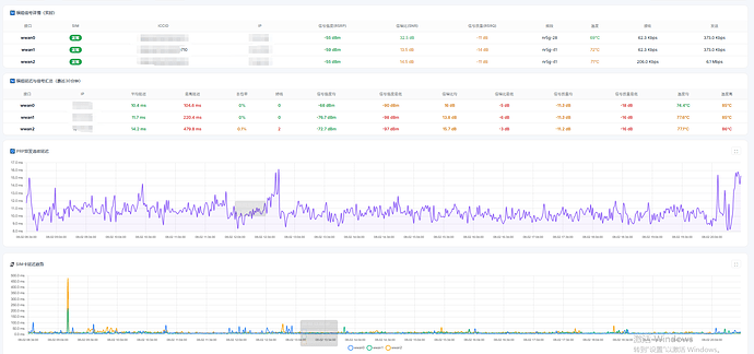

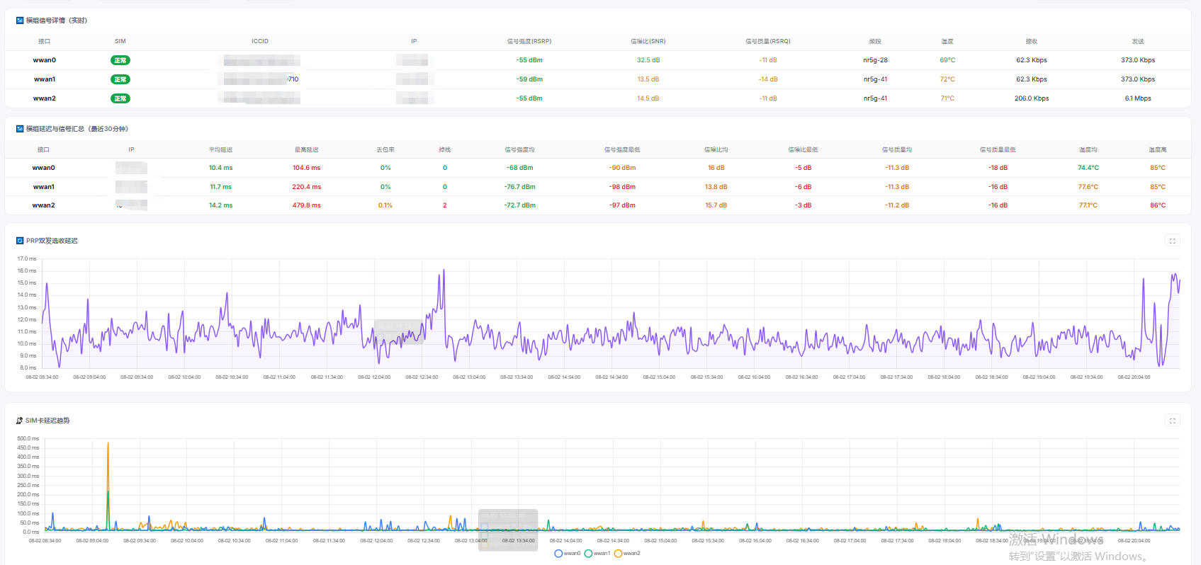

  • Dual 5G modules (ECM/RNDIS) deployed with Linux native PRP over dual GRETAP L2 tunnels
  • Leverages dual 5G modem parallel transmission to reduce end-to-end latency. The PRP duplicate-and-discard mechanism enables hitless zero-failover L2 redundancy, completely eliminating the 100ms–2s service interruption typically caused by 5G cell handovers in mobile industrial scenarios
  • Stable transparent L2 transmission for industrial protocols: PROFINET / EtherNet/IP
Key Optimizations for 5G Industrial Scenarios
  • Resolved SoftIRQ performance bottlenecks under high-frequency industrial control traffic
  • Implemented L2 TCP MSS clamping via nftables netdev hook to eliminate 5G air interface fragmentation
  • Maintained ultra-low latency jitter and achieved 0% packet loss during 5G handover events
Running Status
The solution runs 24/7 stably under harsh industrial conditions. VyOS serves perfectly as a lightweight, software-defined industrial RedBox for mobile private 5G Layer 2 transport scenarios.

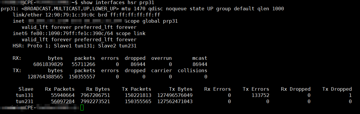

We also integrated HSR/PRP interface creation, configuration, and monitoring into the existing VyOS CLI framework.
Example:
admin@CPE# set interfaces hsr
Possible completions:
 > hsrN                 HSR interface name
 > prpN                 PRP interface name
Example configuration:
admin@CPE# set interfaces hsr prp38
+  address              IP address
   description          Description
   disable              Administratively disable interface
   disable-link-detect  Ignore link state changes
   interlink            Interlink interface
   mtu                  Maximum Transmission Unit (MTU)
   protocol             Redundancy protocol
   slave1               First slave interface
   slave2               Second slave interface
   supervision          Supervision address
   version              HSR protocol version
   vrf                  VRF instance name
