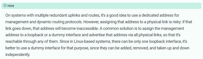

Can anyone share a simple working example of the BGP configuration required for accessing the dummy interface over any interface as explained here..

what you are searching for is loopback, which is reachable across all interfaces. or is there a reason to rely on dummy interfaces? usually you would use loopback interfaces…

You are right, I knew about loopback and I thought it was the same as dummy except the fact there can only be 1 loopback interface..
The plan was to have a dummy interface for management, and another 1 for bgp peering..
Does assigning multiple IP addresses to the lo interface help you out?
Didn’t occur to me that is possible, I’ll check that as well..
