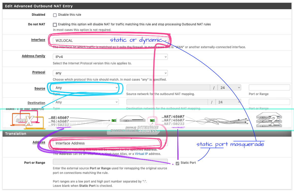

Since obviously I can’t explain myself correctly — sorry about that — I doodlled over a screenshot:
I was referring about source NAT, thought it’s more like a 1:1 NAT since the addresses that would be used for the translation are static and forwarded to a single address, but given I’m both trying to solve a problem, and at the same time educate myself on how to deal with this with more common dynamic addresses, PPPoE as you guys mention — like the example above: it’s dynamically addressed interface used for masquerading anything outgoing through it keeping the ports straight. It’s not used for 1:1, incoming [new] traffic is processed if there are DNAT/PAT rules for it.
In the case of the VyOS instance, it’s very close to 1:1 NAT, the public static addresses of the VyOS router are mostly 1:1ed to a single point down a tunnel, with some exceptions, or at least that’s what I’m trying to replace. But like I said, for 1:1 the address needs to be known which is not commonplace on most small networks.
Thanks again!

So, let me see if I got this,
And thanks for answering BTW. Those three lines are actually the same amount of information required in the setup above (pfSense):
  • Outbound interface
  • Source equivalent to any
  • masquerade” or another placeholder/macro for a dynamic address
    • In pfSense is Interface Address or VIP in the Address drop down menu
And I’m just reading in the screenshot that ports should not be specified with static port translation. That’s odd, since since the filed is cleared and grayed out by the marking the checkbox next. I digress, though not to much since it’s actually related to what follows.
