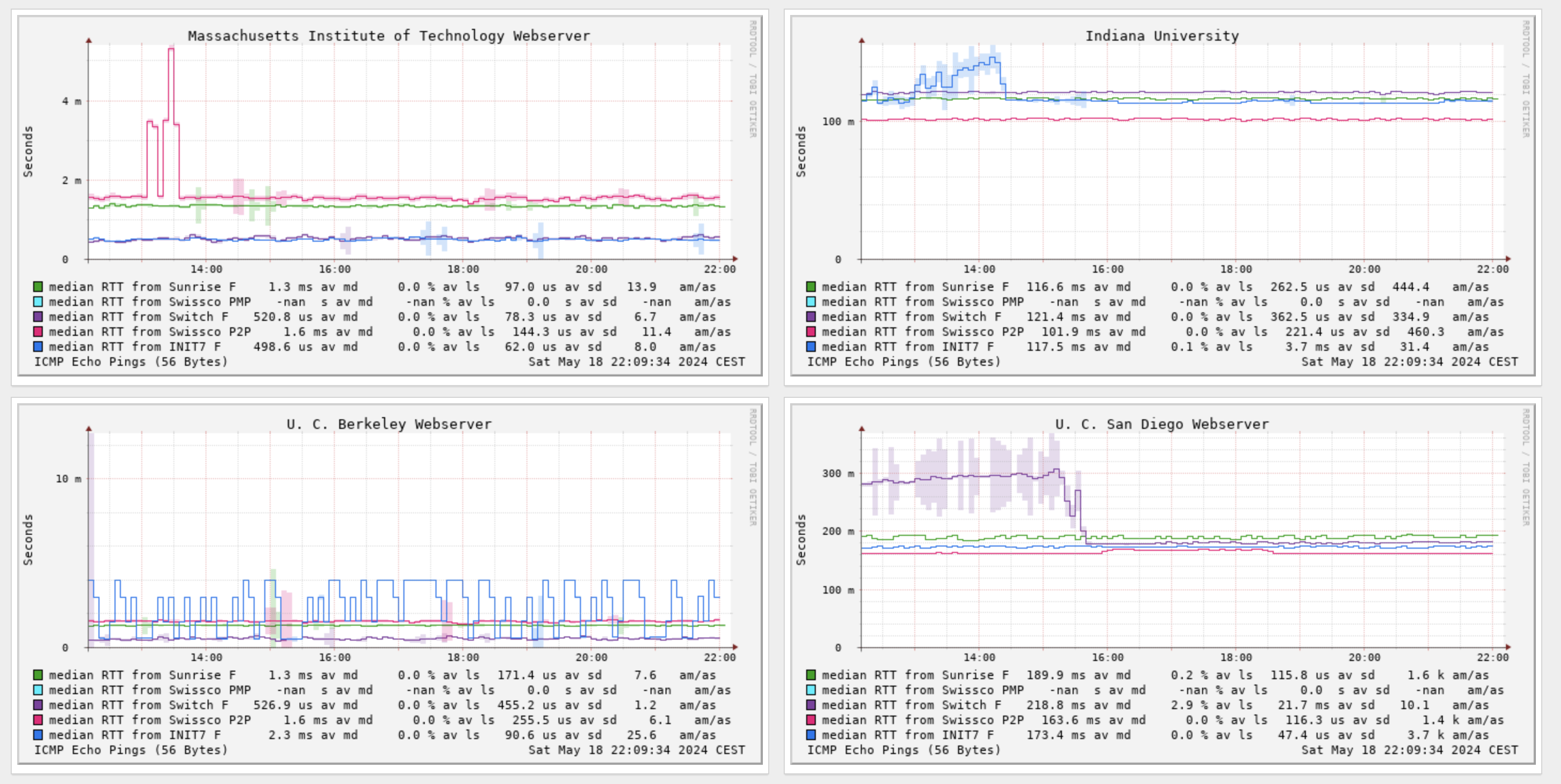

What I’ve done recently is setup Smokeping which can accomplish something similar. It’s pretty easy to do, here’s a quick tutorial and you can also find it on my blog, Smokeping on VyOS | artooro

You should now be able to browse to your VyOS IP on port 8222, for eg. if it’s 192.168.0.1 you should browse to http://192.168.0.1:8222
