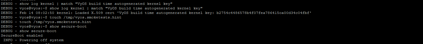

Following the documentation how to build a secure-boot enabled image and then testing it using make testsb yields:
