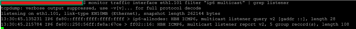

I’m trying to connect up to an IXP, and they are indicating that there is MLD Multicast traffic noise on the links i have with them. Under a TCP dump i can see that there is Multicast Listener traffic. Is there anyway to disable the ipv6 listener on vyos?

Ive already disabled pim6 mld, but that doesn’t seem to do anything.
set protocols pim6 interface eth1.101 mld disable
Any Help would be appreciated.
