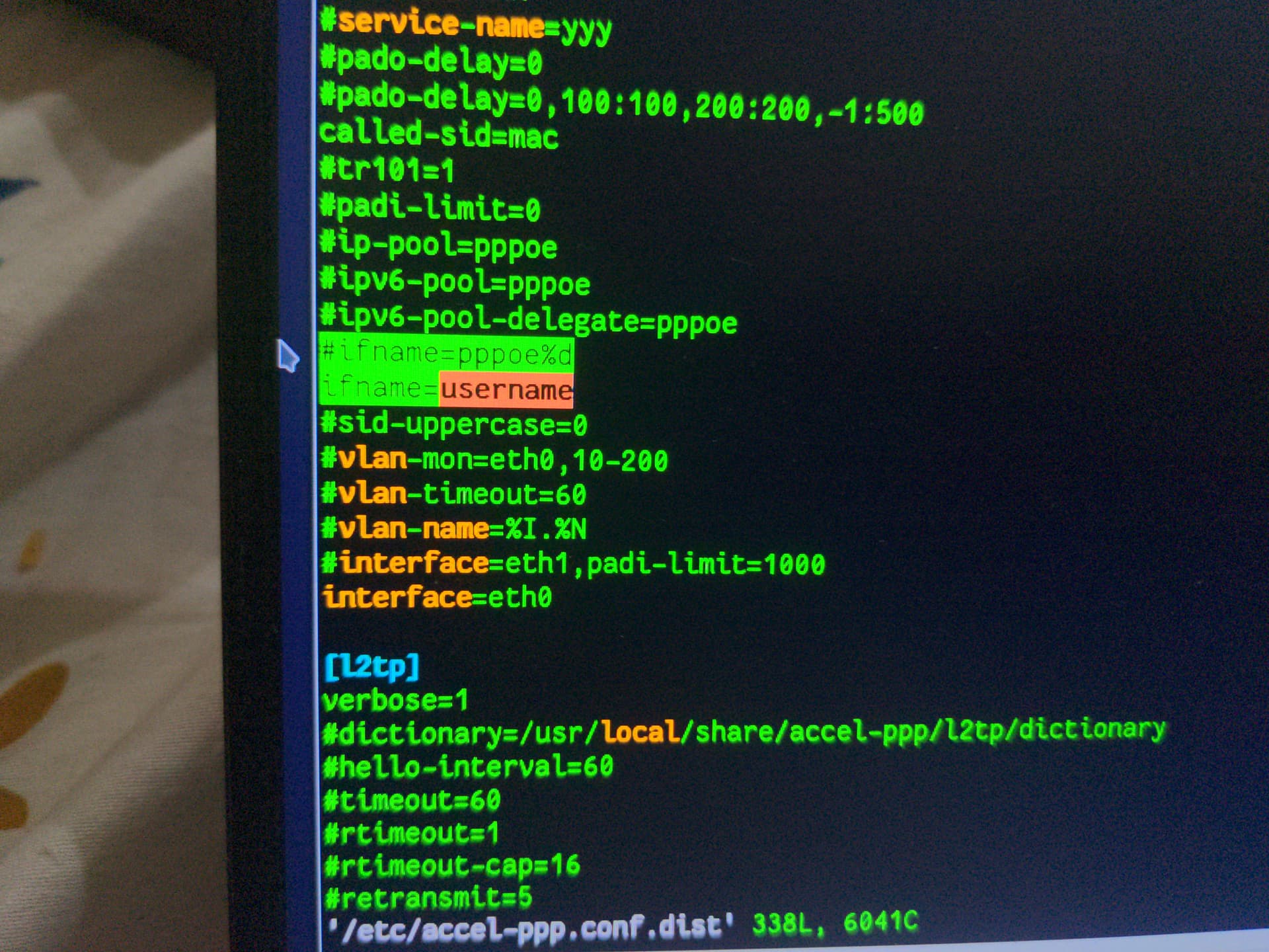

I think if we set this to username issue will be sorted.
That will not work. At best, you’ll end up with 1 user logged in, an interface called “username” and no further logins will be possible. At worst, the daemon will crash.
NAS-Port-Id overrides the mechanism in the configuration file, to force ifname_rename on the session to the RADIUS value, and is subject to the same restrictions (maximum length, only certain characters allowed, etc). Whether it comes from the config file or RADIUS, the string is fed straight to the kernel. It may be an ordinal pattern (the %d part), for an auto-calculated sequence number.
Renaming interfaces like this also a really bad idea, since the namespace is full of special stuff. A user called “lo” is going to really break things.
