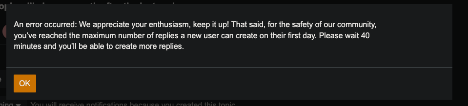

Editing to add this, since I’ve apparently hit the number of replies I can make for the day? >.>

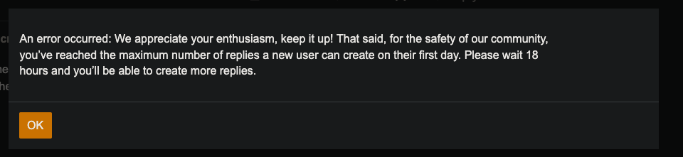

So, I ran sudo cat /proc/net/dev across the VyOS system, the GNS3 host, and the Proxmox host, and on all three they reported zero errors. Took a while to reply because of the posting limit, but… yeah, nothing there.
