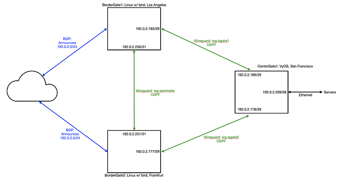

To make this a bit more concrete, here is my setup:
My VyOS router (“CenterGate1”) is connected redundantly to two gateways (BorderGate1, BorderGate2) via wireguard and running OSPF. Both gateways announce 192.0.2.0/24 via BGP and they are also connected via “wg-perimeter” link in case one link goes down.
In-bound traffic works as expected:
  1. Traffic from Europe is likely to come in via BorderGate2 and goes directly to CenterGate1. Traffic from US is likely to come in via BorderGate1 and goes directly to CenterGate1
  2. If either wg-bgate1 or wg-bgate2 is broken, it is first routed through wg-perimeter but still reaches CenterGate1
Now the problem is the out-bound and return traffic: On VyOS I have two default routes, over wg-bgate1 and wg-bgate2 each. But it seems VyOS always prefers just one, say wg-bgate1. Now if I stop bird on wg-bgate1, all return traffic is dropped, even though I now want them to be routed over wg-bgate2.
In particular, wg-bgate1 and wg-bgate2 should be redundant links (carrying the default gateway) that create a resilient connection with respect to:
  • When either link is explicitly down
  • When either link is up but dead (i.e., tunnel endpoint not reachable)
  • When bird on a BorderGate’s is broken/unresponsive
  • When one of the BorderGate’s is down
  • When the internet uplink on either BorderGate is broken
How can I configure VyOS accordingly?
Also, would it be preferable to not use OSPF in the first place but iBGP instead? If yes, why?

I am not sure I understand correctly (and how it has to do with ECMP) but the two default routes are static routes:
protocols {
    static {
        table 33 {
            route 0.0.0.0/0 {
                next-hop 192.0.2.177 {
                    distance 20
                next-hop 192.0.2.185 {
                    distance 20
