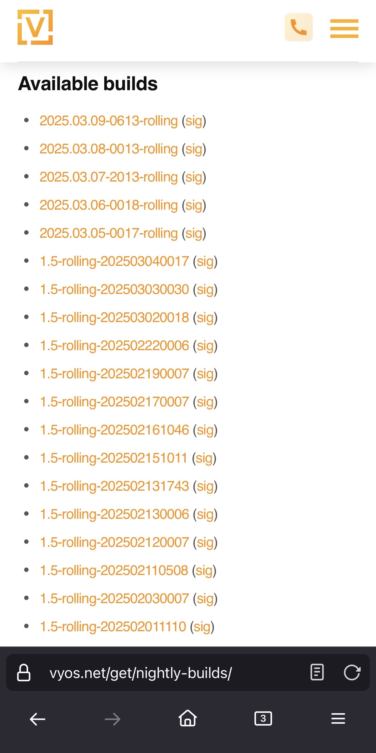

Nightly build images changed naming convention?
The list of nightly build images available for download shows the images have historically had the naming convention 1.5-rolling-<datetimestamp>, however the most recent 5 images are using naming convention <datetimestamp>-rolling.
https://vyos.net/get/nightly-builds/
Is this a recent change in naming convention, or are these most recent images always different to those from a week or so ago (e.g. a different release train)?

The problem exists but the naming pattern change is not the cause, they are unrelated. We’ll find a fix for it, broken changelogs are indeed quite bad.
To clarify - can you please confirm that there was a deliberate naming pattern change, and future nightly builds will continue to use this new naming pattern?
I also note that the version.json is not being updated with these newer images with the newer names, so people running nightly won’t be seeing the available updates:
The naming change is expected
I have filed this as a bug over at:
