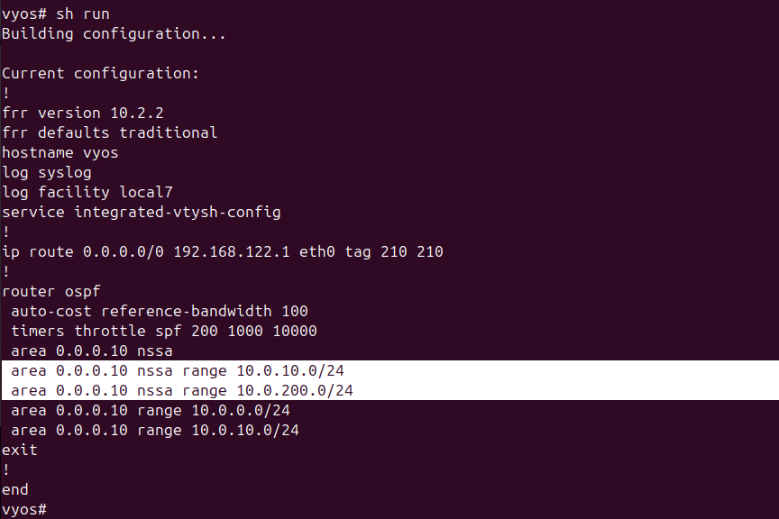

I probably found a bug when i try to “set translate ‘never’” and no-summary in an nssa area, what i see on vyos it’s different from what is setted on frr…
sh conf commands, show it correctly:
set protocols ospf area 0.0.0.10 area-type nssa no-summary
set protocols ospf area 0.0.0.10 area-type nssa translate ‘never’
But if i check on frr:
router ospf
ospf router-id X.X.X.X
auto-cost reference-bandwidth 100
timers throttle spf 200 1000 10000
redistribute nhrp
network X.X.X.X/32 area 0
network Y.Y.Y.Y/28 area 0
network Y.Y.Y.Z/28 area 0.0.0.10
area 0.0.0.10 nssa
exit
I can set it from vtysh in this way:
area 0.0.0.10 nssa translate-never no-summary

Hi from frr, using vtysh, chen i change something from vyos conf , all data after "area 0.0.0.10 nssa " are wiped…

Because summary for LSA 5/7 are not aggretate from frr, because aggretate syntax is different for LSA3 and 5/7

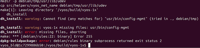

Hi I’m trying to build vyos-1x with patched file..
I used the docker I used to build my ISO:
docker run --rm -it --privileged -v $(pwd):/vyos -w /vyos vyos/vyos-build:current bash
I setted env VYOS1X_REPO_URL, but i cannot set branch my branch, i tested using flavour but if i set branch test, it is used also for other repos…

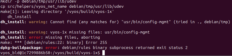

After building an ISO successfully, I tried to build deb packages with my patch, doing checkout of my branch in /vyos/build/vyos-1x, I used dpkg-buildpackage as i saw on forum…
I had some trouble with testing on ipv6, i commented them… but now i have this error
I searched online without success…
