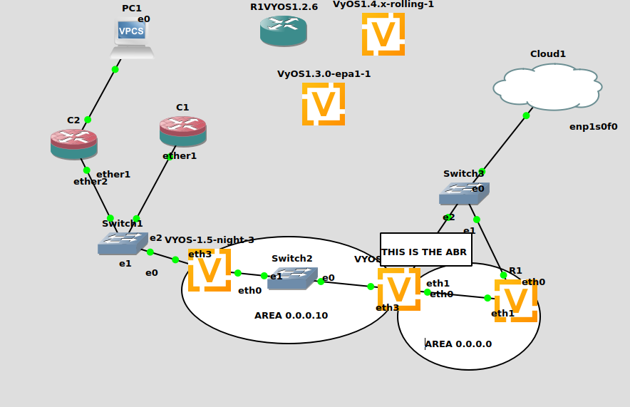

Good evening,
I was doing some test with OSPFv3 / IPv6…
If i create a NSSA , the ABR see the redistributed routes as local connected… and those routes become unreachable, because instead to send packets to via address it try Neighbor solicitation.
If I convert NSSA to a normal area, the same redistributed routes get correct via and all routes become reachable.

After removing nssa from area-type “RIB” become correct… I double checked VYOS CLI and VTYSH, because in some condition when i add and remove area-type vtysh -e “show run” is not updated.

I tried with rolling and stream, with same results… did someone had same issue?
