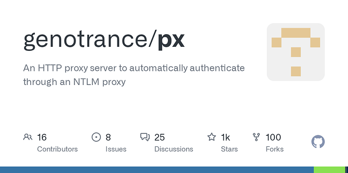

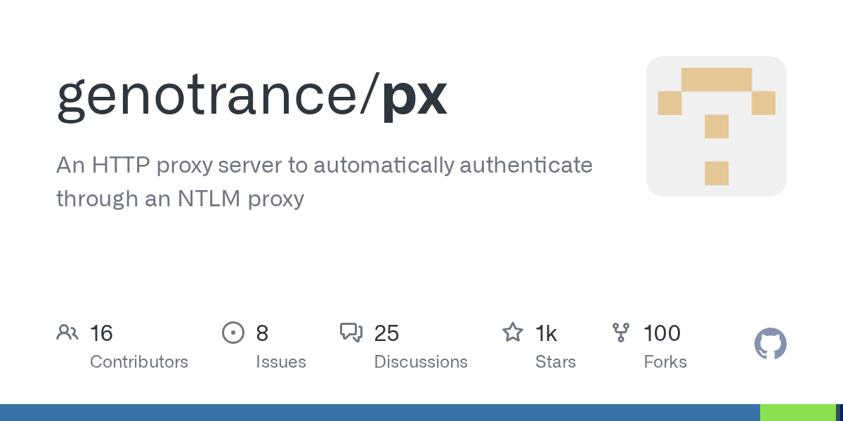

px is the newer version
How to survive behind an enterprise proxy ![]()
