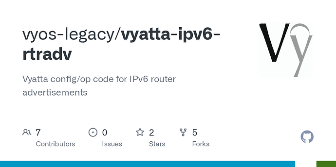

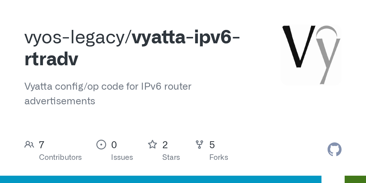

Is this:
a Debian package, which I can edit, compile and install on crux?
Mebus
Hello @Mebus, yes, I think it will be solution. Do you need help with building package?

I think you can clone from git and build from docker container.
  1. Enter to docker container
docker run --rm -it --privileged -v $(pwd):/vyos -w /vyos vyos/vyos-build bash
  1. Get necessary source code
git clone https://github.com/vyos/vyatta-ipv6-rtradv.git
  1. Need choice commit and patch files
cd vyatta-ipv6-rtradv
git checkout crux
# add patch or make changes manually
  1. Build package
dpkg-buildpackage -us -uc -b
  1. Upload this deb file to your router and install it
sudo dpkg -i package_name.deb
