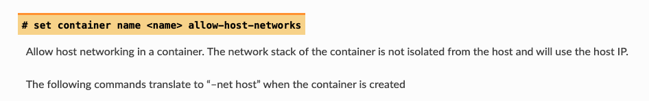

Does set containter name adguard allow-host-networks help at all?
I suppose it might but that would be host networking which I don’t want and it would interfere with the DNS forwarding service on the host.
