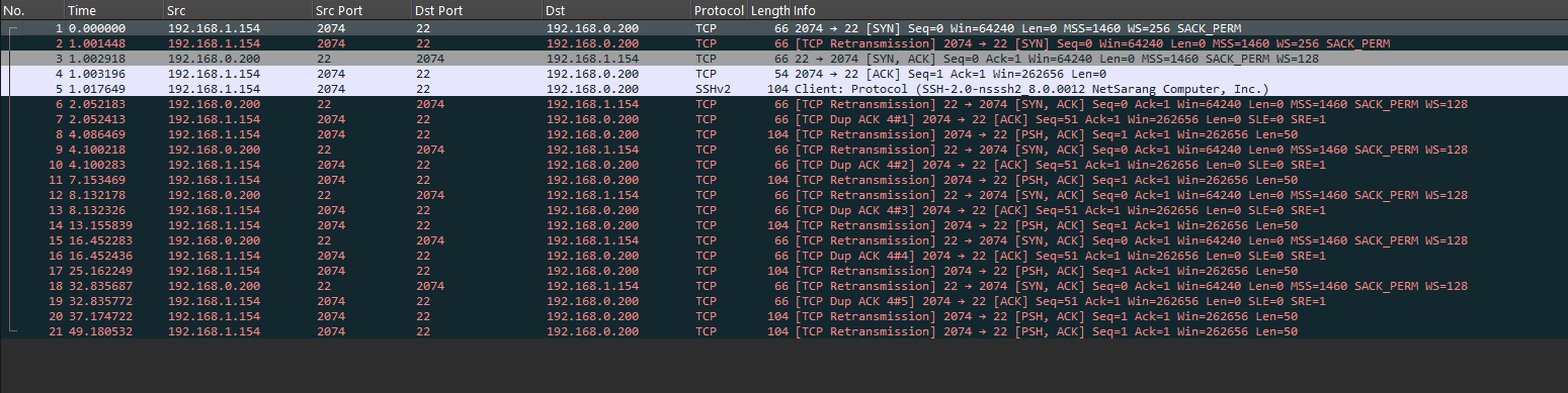

This is what I am getting when attempting to SSH to the device.

The server-key command hangs on 1.4 and the pki command throws a python exception. I have not tried the server-key command on 1.5 releases but all versions attempted have raised the same exception. I will try and make some time to gather additional information today.
