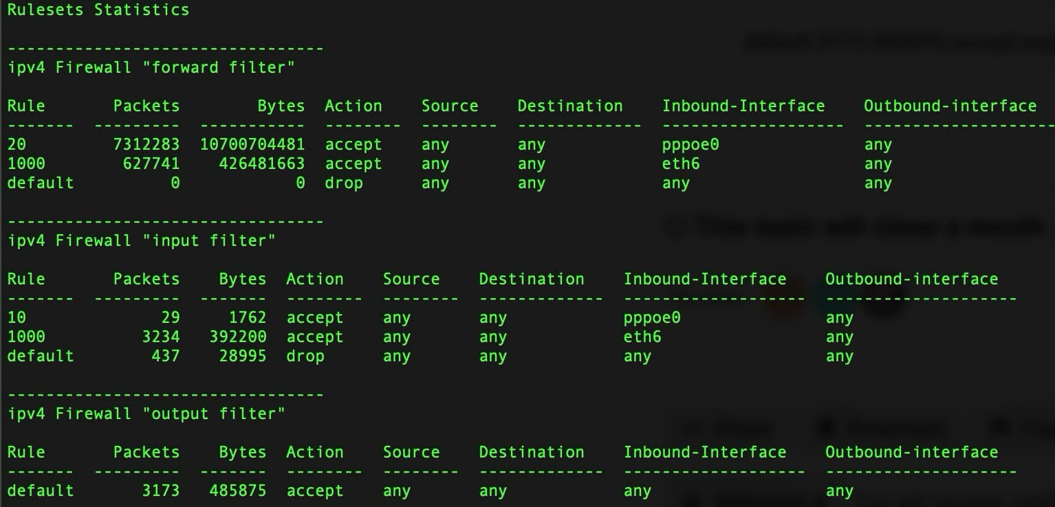

Trying to get Vyos up and running as my main router to ISP. And having a strange issue. My connection comes up I get IP address. All is well, however shortly after I am starting to have a issues / timeouts.
Pings don’t interrupt and are continuos, pppoe stays connected, there are no errors, dropped packets or collisssions. Firewall looks ok as well. I have tried to play with MTU and there is no change that I can tell.

How is your settings?

set firewall ipv4 forward filter default-action 'drop'
set firewall ipv4 forward filter rule 20 action 'accept'
set firewall ipv4 forward filter rule 20 description 'Allow Return traffic through the router'
set firewall ipv4 forward filter rule 20 inbound-interface name 'pppoe0'
set firewall ipv4 forward filter rule 20 state 'established'
set firewall ipv4 forward filter rule 20 state 'related'
set firewall ipv4 forward filter rule 1000 action 'accept'
set firewall ipv4 forward filter rule 1000 description 'Allow All from LAN interface'
set firewall ipv4 forward filter rule 1000 inbound-interface name 'eth6'
set firewall ipv4 input filter default-action 'drop'
set firewall ipv4 input filter rule 10 action 'accept'
set firewall ipv4 input filter rule 10 description 'Allow Return traffic destined to the router'
set firewall ipv4 input filter rule 10 inbound-interface name 'pppoe0'
set firewall ipv4 input filter rule 10 state 'established'
set firewall ipv4 input filter rule 10 state 'related'
set firewall ipv4 input filter rule 1000 action 'accept'
set firewall ipv4 input filter rule 1000 description 'Allow All from LAN interface'
set firewall ipv4 input filter rule 1000 inbound-interface name 'eth6'
