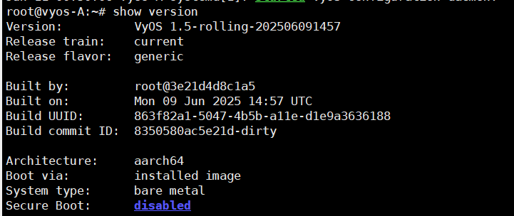

You tell us nothing about the hardware, nor the version of VyOS you have.
Do you have a serial port on ttyS0?
What version of VyOS etc.

So it is some customer build issue, or the platform doesn’t have serial devices
Something similar for ARM was here ⚓ T7484 ARM64 config fails to commit due to ttyS0 console

Is the arm64 architecture the default serial port interface for ttyAMA0?
