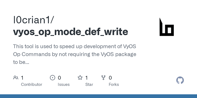

TOOL: Op Mode Definition Write Tool
I previously created a tool to help generate the XML for Op Commands which can be found here:
I created a new tool to help speed up testing of new op commands. This tool will write the XML file for the new op command to the /opt/vyatta/share/vyatta-op/ directory, so it can be immediately called.
The new tool can be found here:
