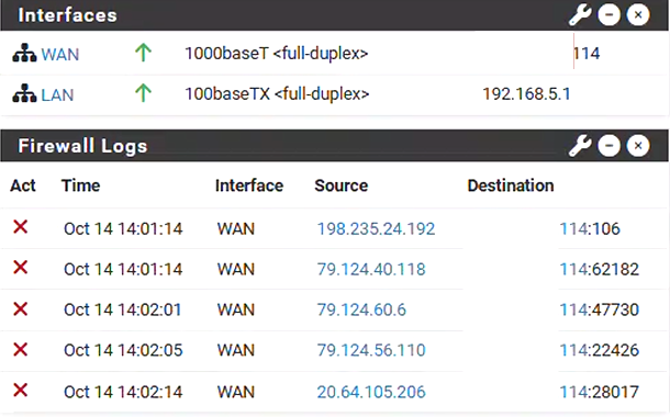

You can see that the pfSense connected to Vyos is receiving traffic, but it’s unable to send outbound traffic. I think I might be missing a firewall rule on Vyos.

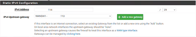

  • VyOS (eth2) has the gateway .113
  • pfSense is assigned .114
