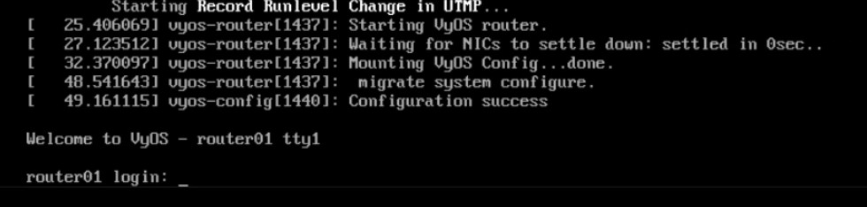

I cloned the VM (just in case) and ran the installer for the new rolling iso. It asked me if I wanted to bring the config over from the existing installation that it detected automatically.
It was smooth as butter. I really can’t tell the difference in the config other than better indentation.
When I get home I’ll switch to the new VM and see if it works, but I’m expecting no issues.
