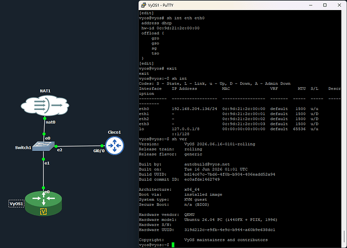

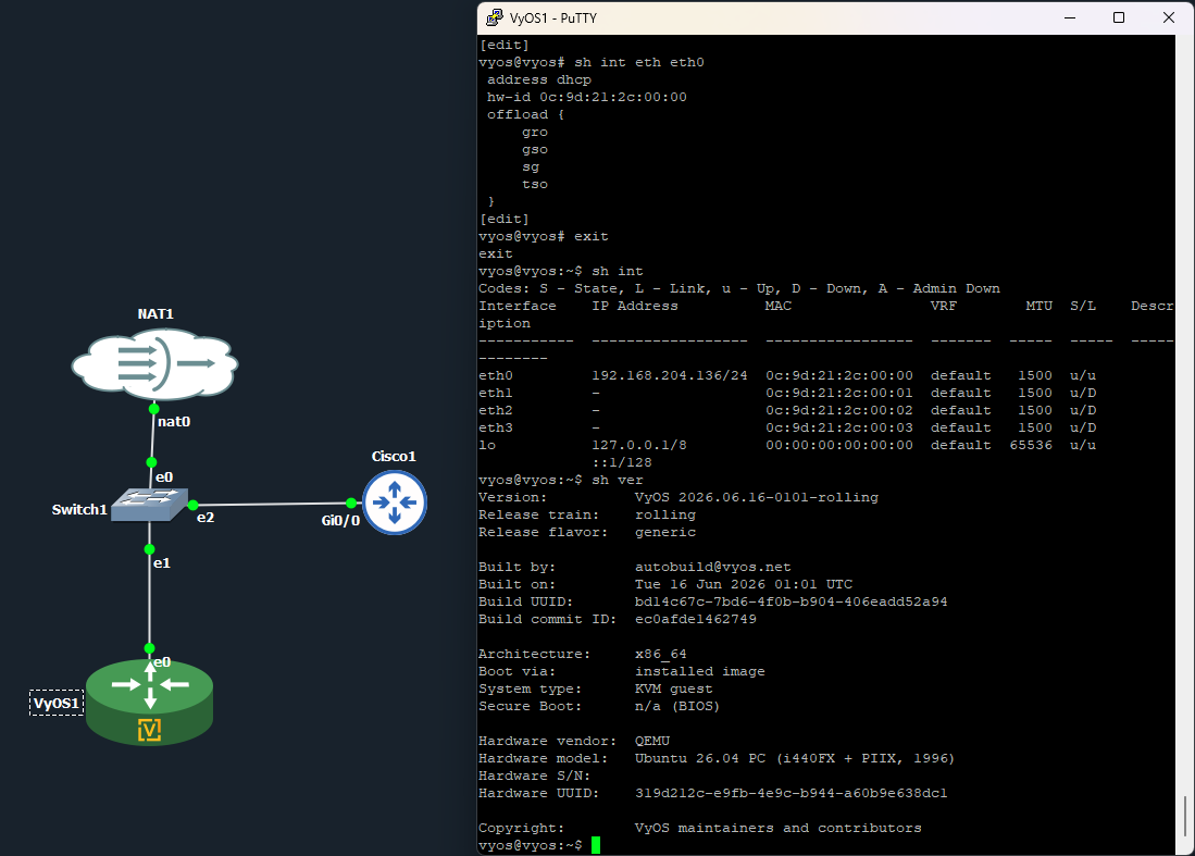

My interface config:
vyos@vyos# sh int
ethernet eth0 {
address dhcp
hw-id 0c:e1:01:14:00:00

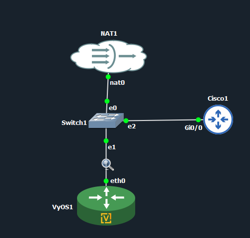

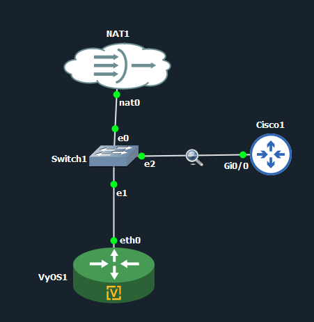

My topology:
Switch config (default):
Expected behavior: The VyOS router eth0 interface gets an IP from DHCP, just like the Cisco router connected to the same switch does.
Actual behaviour: VyOS router is unable to get an IP from DHCP when connected to the switch. DHCP works when directly connected to the NAT node, but doesn’t even initiate a DHCP discover request when connected to the Ethernet switch in GNS3. The router claims it’s sending DHCP requests on eth0, but they don’t show up in the wireshark pcap.
Logs and PCAP attached. PCAP Setup:
VyOS-2026-03-Logs.txt (12.8 KB)
PCAP_Text.txt (6.3 KB)
PCAPNG File here.
P.S. Almost certainly a bug, since the rolling release don’t have a problem with this, and works absolutely perfectly.
