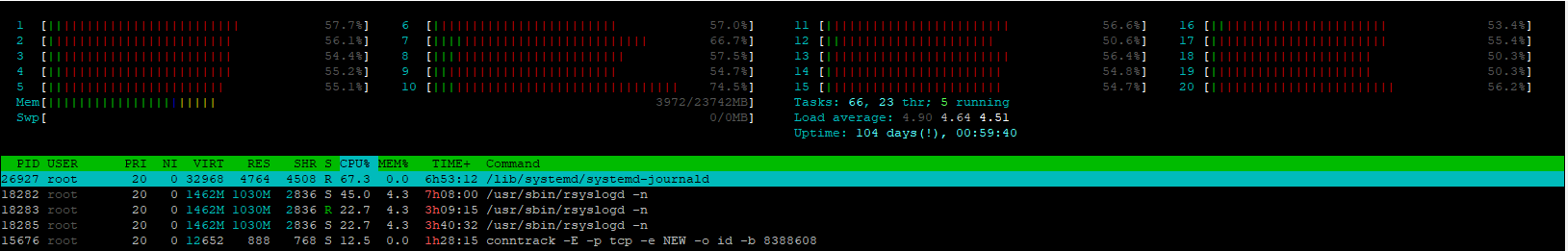

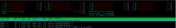

We use source nat, I planned to update and use cgnat. When logging via syslog, the systemd-journald process consumed too many resources and during rush hour the logs stopped running. Are the syslog settings different for cgnat? And is there an option to do optimization so as not to lose nat logs?
