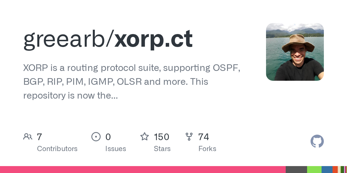

XORP is still doing stuff, at least merging PRs.
