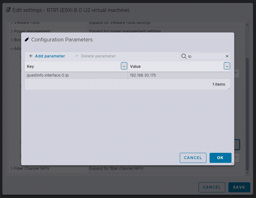

After testing several things, I finally got it to work via OVA itself as its much more scalable..
The idea is basically to install vmtools in the VyOS, add a script to receive values from vmtools which are injected into the VM’s VMX file after OVA is deployed but before the VM powered on..
vmtools are installed below (provoided all networking is in place, it will download vmtools, run it, and run on boot as well)

Once this is done, I repackage it as an OVA, and deploy it via Ansible as below..
PLAYBOOK

    - name: Configure Guest OS Settings
      vmware.vmware.vm_advanced_settings:   # <=== The Ansible module for configuring the VMX file
        hostname: 192.168.30.76
        username: root
        password: password
        validate_certs: false
        state: present
        settings:
          guestinfo.interface.0.ip: '192.168.30.175'   # <=== Using guestinfo.interface.0.ip under settings, these will receive the values upon boot in vmtools
          guestinfo.interface.0.netmask: '24'   # <=== Using guestinfo.interface.0.ip under settings, these will receive the values upon boot in vmtools

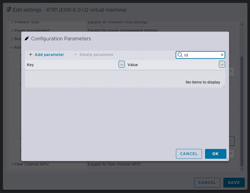

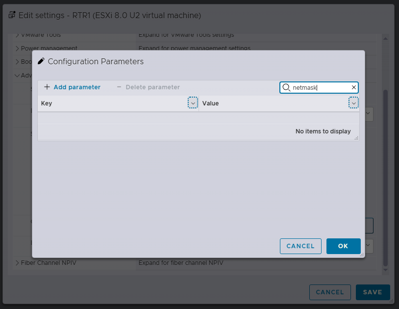

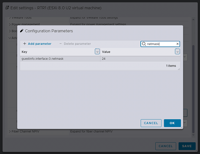

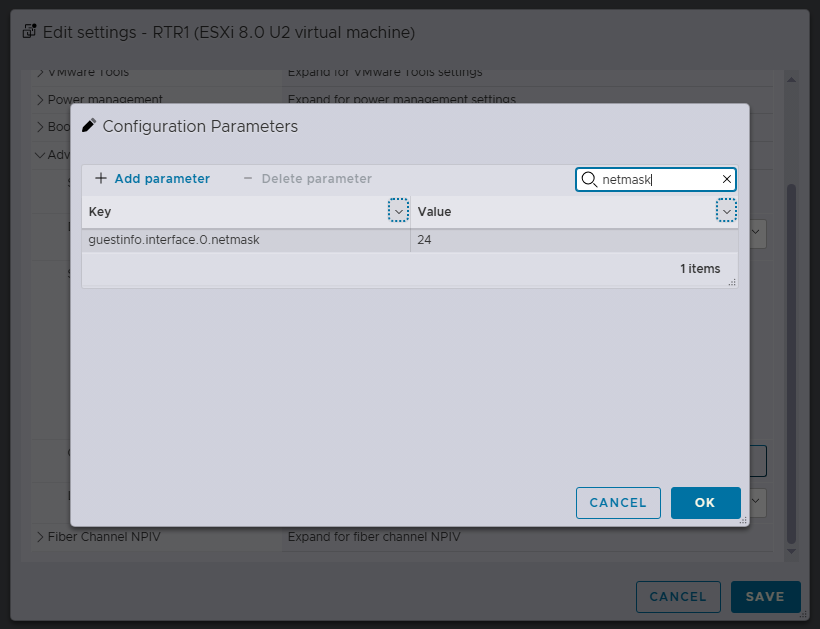

BEFORE VMX INJECTION
AFTER VMX INJECTION
