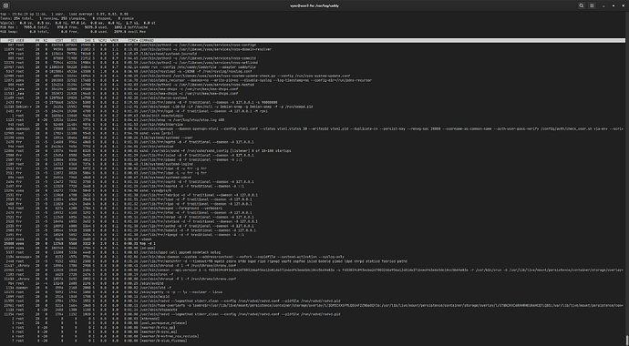

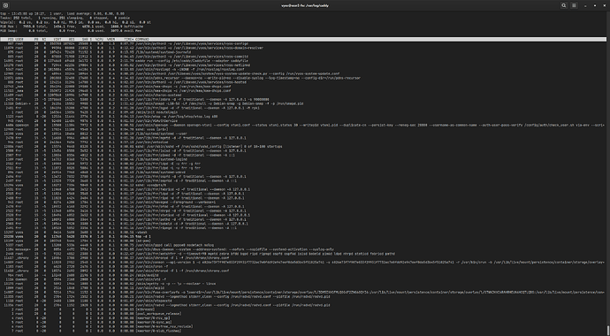

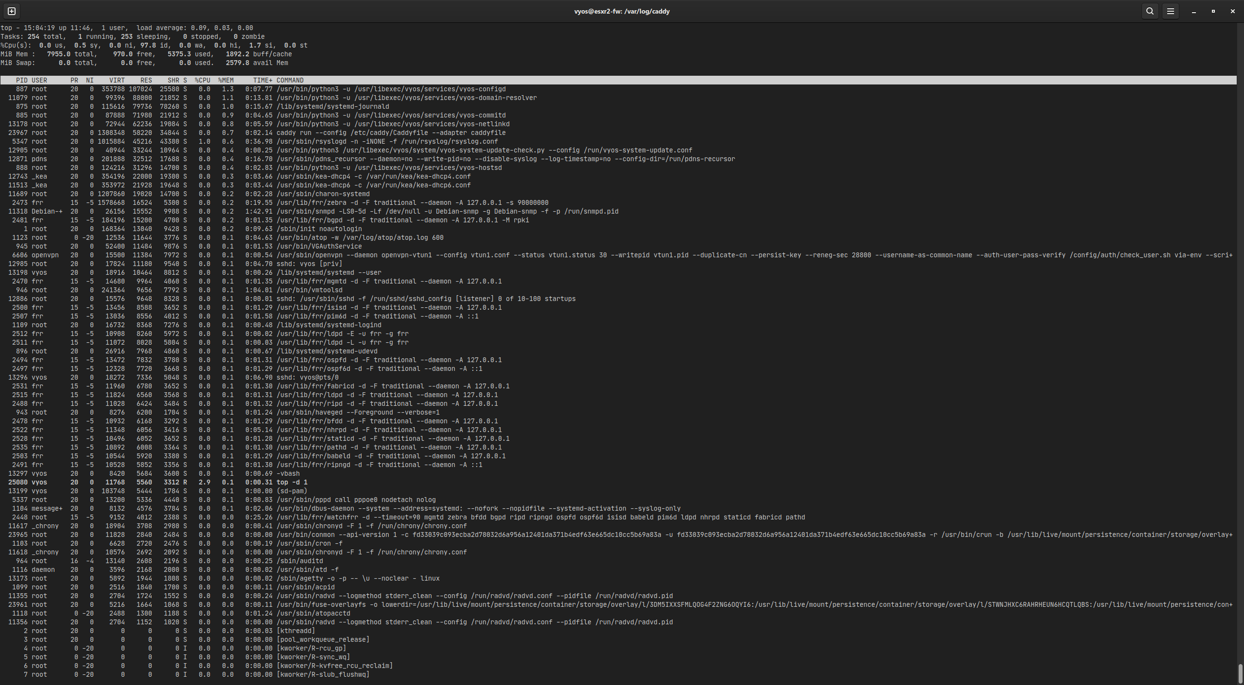

I’ve migrated the second of our Sophos UTM firewalls to VyOS yesterday. It seems to have a memory leak somewhere, as something is eating up about 200MB per hour, but a “top” sorted on memory usage doesn’t display any difference if I compare with an hour difference:
If I look at the monitoring of the first one, it has been stable at about 16% memory usage over the last two weeks.

As a test, I have disabled the container and rebooted the router, but that doesn’t make any difference, watching top you see available memory continuously decreasing:
Is there a memory utilisation issue with strongswan?

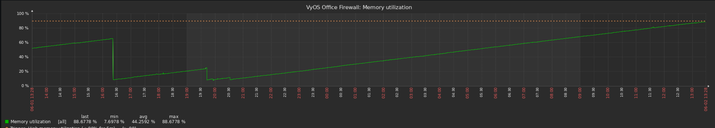

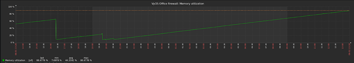

The last crash happened at 04:10 this morning, and was preceded with quite a spike in memory usage, as seen on the monitoring graph.
At 04:00, a backup started from the local office NAS to the DC backup server, which goes through the IPSec tunnel.

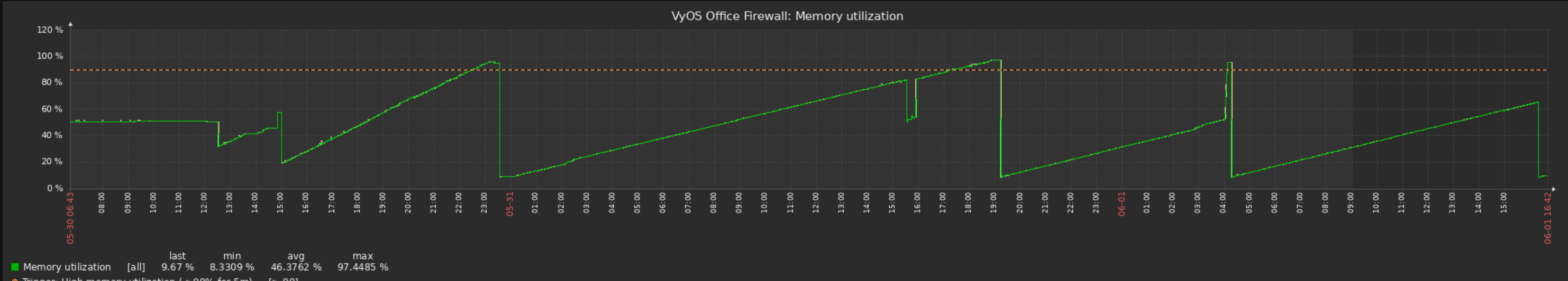

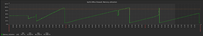

It is about to go again:
It takes about 18 hours to gobble up the 7GB that is free after the router boots.
I don’t think it is IPSec traffic (or fragmentation) related, overnight about 50GB was rsynced through the tunnel, with no impact whatsover to the steady liniar increase of memory usage.
