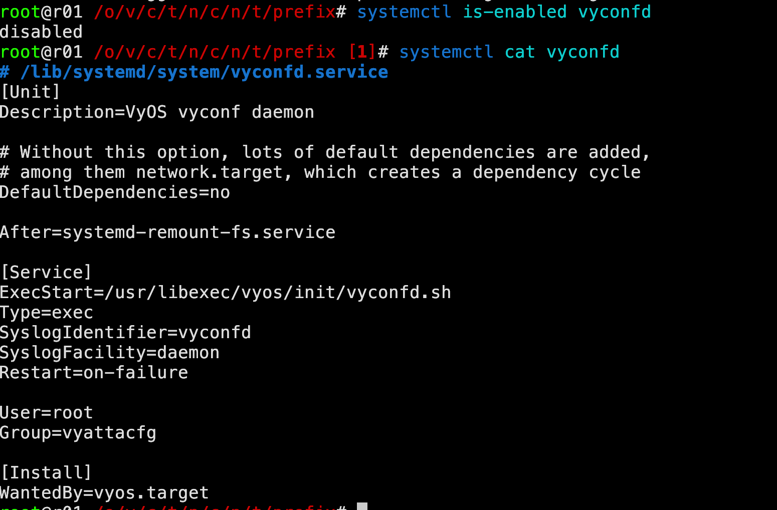

What is service vyconfd used for?
I found the service is disabled .
vyconf is the future replacement of all of the legacy Vyatta code still present in VyOS. It’s still a work in progress which is likely why it’s disabled.
is it safe to enable it ? how to test it ? thanks !
It will almost certainly break something if you enable it. To my knowledge it’s not complete.
Maybe @jestabro can provide more info.
@L0crian is correct that it is not yet complete: there remains some final details of integration with CLI, before it can be considered for testing. Simply enabling the vyconfd service will have no effect, nor is recommended. However, it is expected to be in internal testing later this summer, and instructions can be provided for any one willing to help with that testing.
